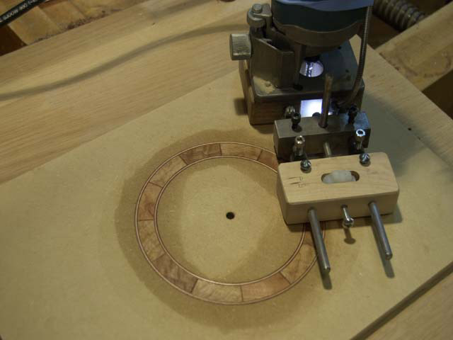

Just to show that they don't have to look good to work......
BTW, check out Sylvan Wells website to see how stuff like this should be made!
Jig for the lam trimmer to cut rosettes and soundholes. This is the basic Don Teeter Dremel jig, updated along the lines described here by a number of folks. I had to go through my collection of lam trimmers- some have bases that won't let you get a centre close enough to the bit to cut smaller rosettes and soundholes. This is a Bosch which I'm not that fond of, but it works for this.
I put some drill collars on the rods so that I can 'save the setting' if I'm making a bunch of similar cuts. The LED is just a flashlight strapped to the router.
Hardwood taps well, so you can use machine screws for locking, etc. (Please note the AAAA grade fine-grain tonewood that holds the rosette..)

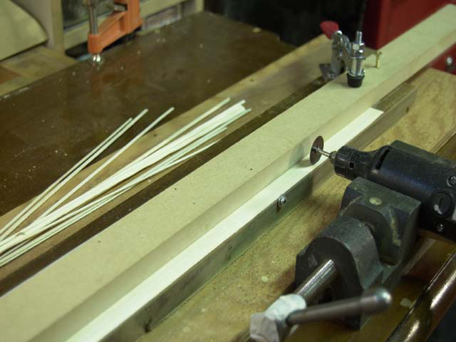

The other one is my 10 minute 'veneer lumbermill' for making veneer strips - a trip to the scrap pile and some drywall screws were required. The toggles could be replaced with clamps- I've had these lying around, waiting to be used.
The Dremel is held in a small drill press vise and slid along. It makes cutting strips a bit easier, though it would be just as effective to use the same jig with a knife for cutting. The main idea was to get my fingers away from holding a straightedge. The clamping boards have sandpaper to help prevent the veneer from sliding around.

Vey neat rosette cutter, beautiful rosette and clever set up to cut your veneer strips John, do you have a better pic of your set up, care to elaboratemore on this please? Do you feed the wood by hand or push the vise via a sliding bar?

Now that's a gorgeous rosette! I like your veneer cutting set-up - clever and simple. You could adapt it to cut MOP as well -- cool.
The rosette looks like spalted maple to me? What kind of wood did you use for the dark lines?Anthony Z39068.4415509259

Yeah I like the veneer cutting jig. I need to set that up for myself.
Lance had something similar for cutting abalam sheets I seem to recall.

[QUOTE=Serge Poirier] Vey neat rosette cutter, beautiful rosette and clever set up to cut your veneer strips John, do you have a better pic of your set up, care to elaboratemore on this please? Do you feed the wood by hand or push the vise via a sliding bar?[/QUOTE]
Thanks, Serge.
You are asking about details of the veneer cutter?
It's very simple- I just slide the drill press vise along- it rides against the edge of the plywood. I just push it by hand- I keep out of the 'line of fire' of the blade and everything is pretty low power so I'm not worried too much. I take it fairly slow. The saw 'just' cuts through the veneer- almost like scoring it as much as cutting. The veneer 'stays put'- the 'saw bed' is screwed to the jig base, and the clamping bar is on top of the veneer, indexed with a couple of screws in loose holes, and clamped with the toggles.
I can send more pics but I don't know that they would clarify much- let me know.

[QUOTE=Anthony Z]
The rosette looks like spalted maple to me? What kind of wood did you use for the dark lines?[/QUOTE]
Thanks.
The rosette is mostly Arbutus (madrone?). These are some of the 'scraps' and less-figured stuff from the pile. Some spalting but a lot of interesting curl and burl as well. I've sawn some sets and will give it a try soon.
The darker lines are mahogany veneer. I just grabbed something straight-grained and dark-ish from the LeeValley veneer box. White line purfling is maple- I think!
As you probably know, it's a lot easier to put these rosettes together with lines between the segments, especially if you are using a water-based glue. It helps to hide mistakes!

John, is the MDF a form for your rosette or was that just so you could do show and tell?

Thanks much John, it won't be necessary to elaborate furthermore, i think i had my first sip of coffee when i asked!    I'll be able to build me that fantastic jig my friend, thanks again!

[QUOTE=Aoibeann] John, is the MDF a form for your rosette or was that just so you could do show and tell? [/QUOTE]
It wasn't for show and tell, really. I just took a pic when it turned out OK.
This was the first rosette of this type I'd made and I was also trying out the new jig with the lam trimmer, new cutter, etc. Just getting my hand in after 20+ yrs away from guitar building.
I wanted to run one rosette (made with 'scrap') through the process to see how everything worked before I started on a soundboard. The MDF was at hand when I looked for something flat to glue the rosette into.
I actually prepared the 'ring' of arbutus in a two step process (glue up segments with epoxy, then transfer to a ply workboard (tack down with 5min epoxy in a few spots at the edges) for thickness sanding and cutting to circular shape.
I was surprised it worked OK the first time.

I didn't know if you had fabricated a form to use and just wasn't seeing how you were going to get the rosette out. It turned out so nice it would be a shame not use use it.
